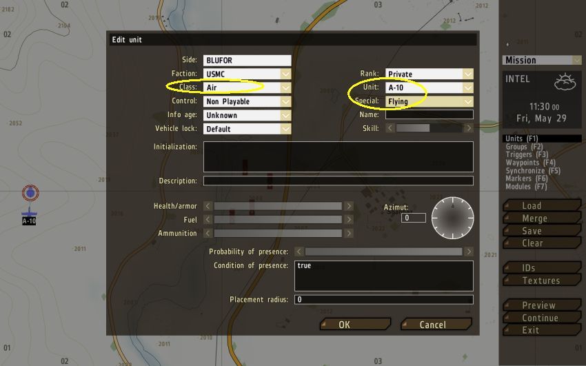

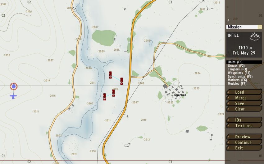

First place a man (you) on the map, then place an A-10 near him as below, REMEMBER to set the A-10 to 'Flying', it doesn't need waypoints and will circle overhead waiting for you to call it in-
Then place a few Opfor trucks-

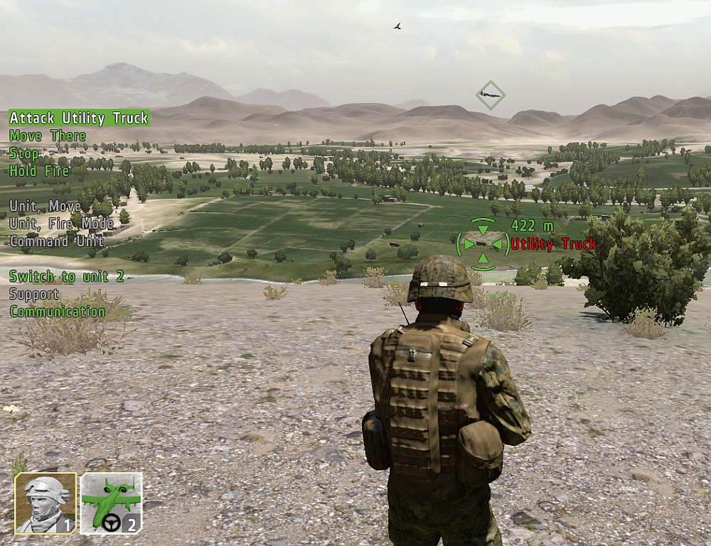

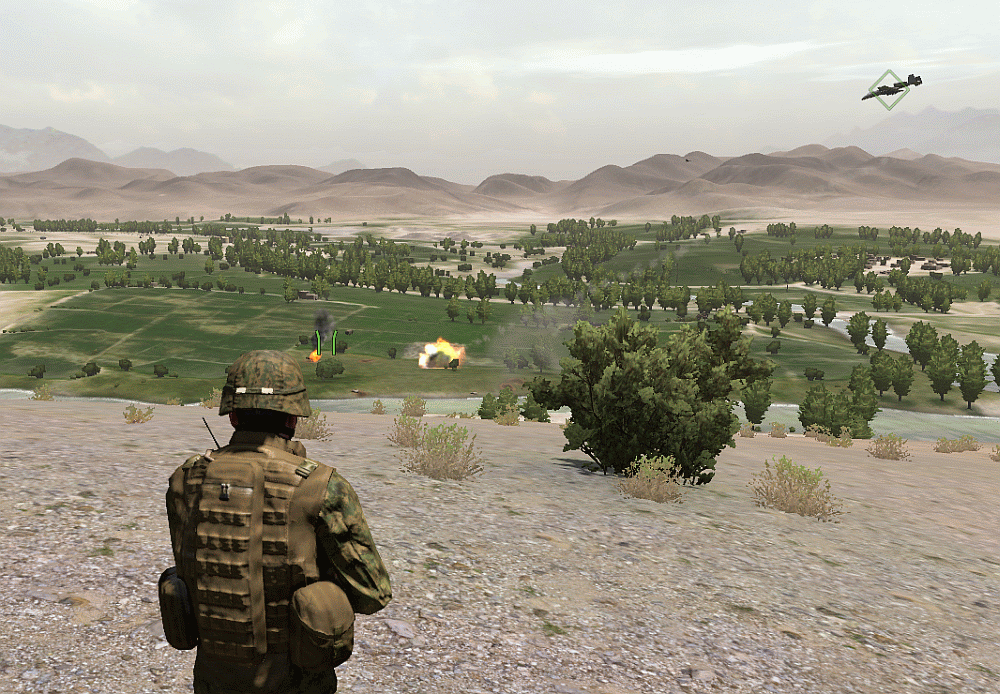

Get on the radio to the circling A-10 by hitting 'F2', point at the target you want it to zap, then transmit the order with a left mouse click.
The A-10 will then position itself for the attack run and whammo, it strikes with rockets and gunfire-

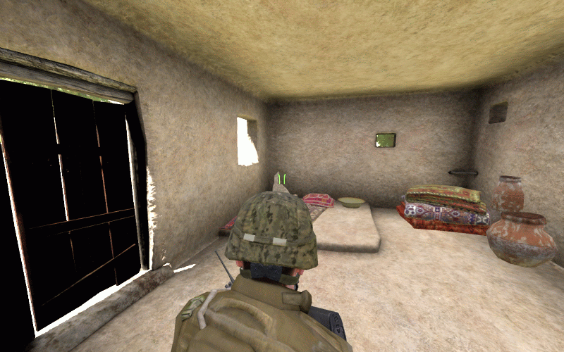

I exit the Editor and begin the game, and run into this house just to show you can direct air ops from indoors or anywhere else if you've got a map and radio-

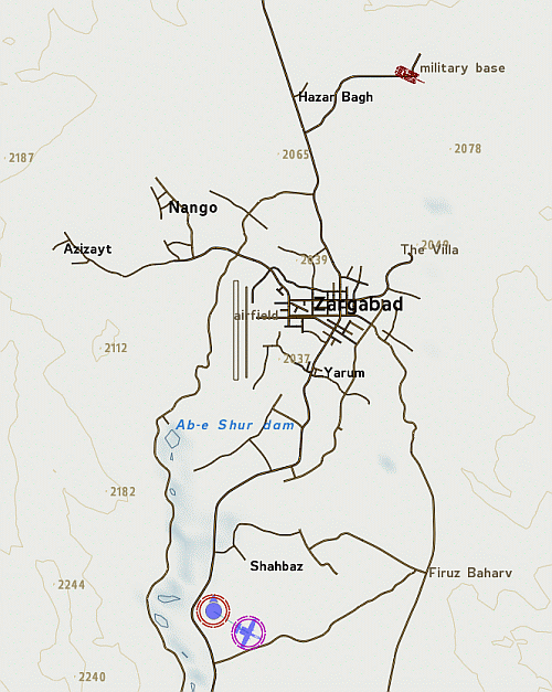

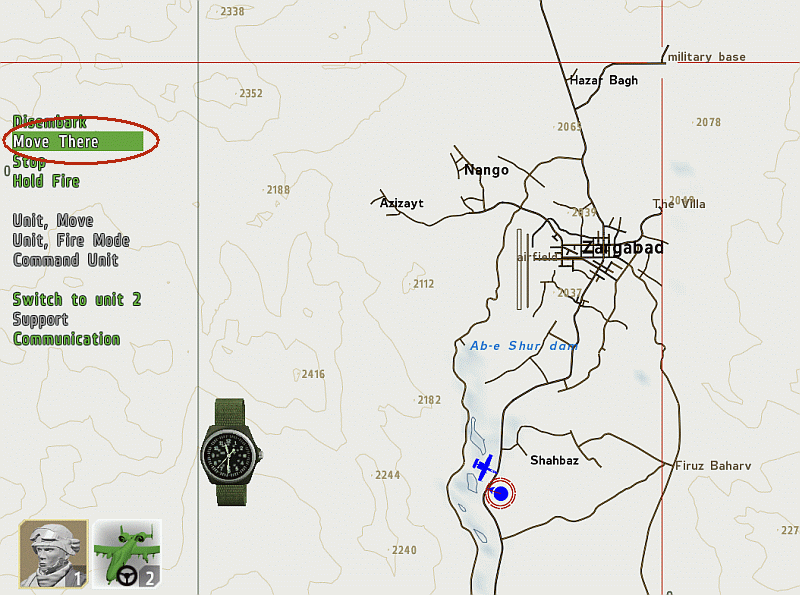

The A-10 orbits its starting position; note that the T-72 has vanished from the map because it's too far away for the A-10 to spot it-

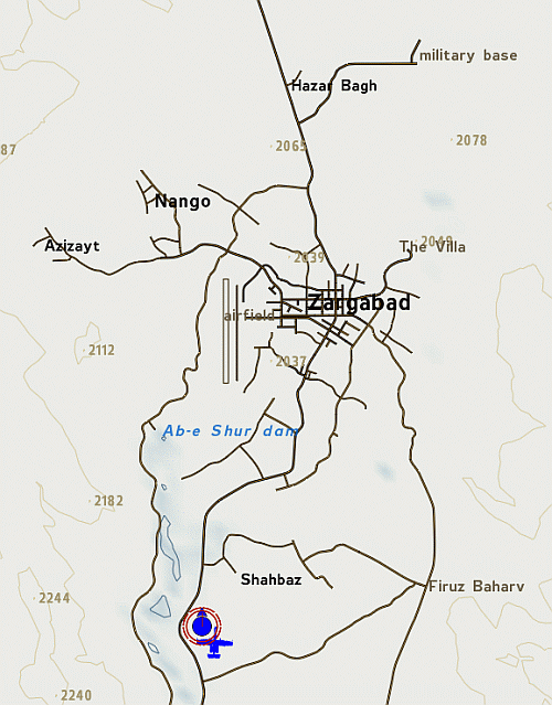

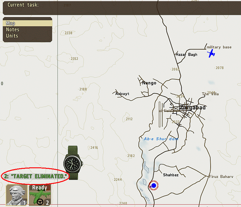

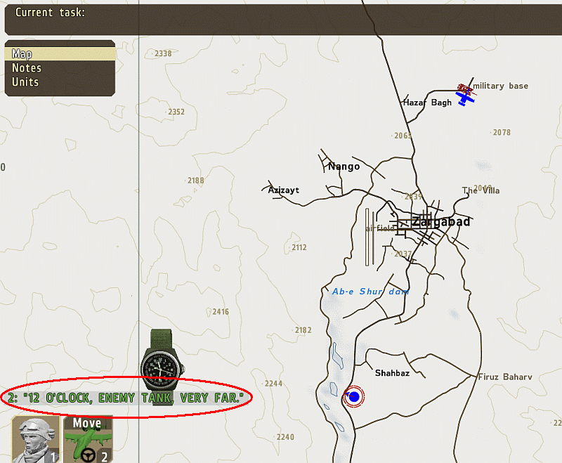

So I hit 'F2' to open a radio link to the A-10, and click on the mil base to send it flying off up there-
Aha!, the A-10 radios back that its sighted the T-72, and its red icon appears on the map-

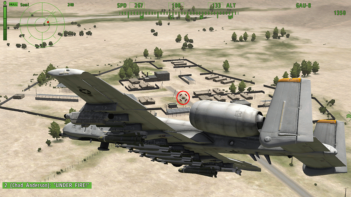

Yup there it is smack in the middle of the mil base and is firing at the A-10 with its AA MG, cheek!
Okay, it wants to play rough so I go back to the map, get on the radio to the A-10 (key F2) and click on the T-72 to order the A-10 to zap it-
The A-10 struts its stuff and the T-72 is blown off the map, and the A-10 radios back to tell us-
Yup, the T-72 is toast-

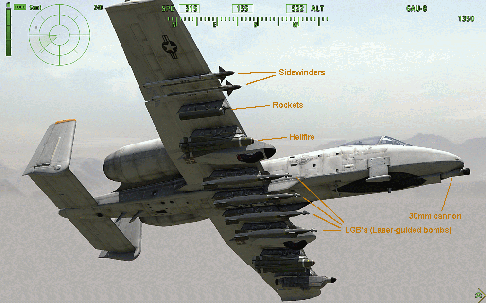

The A-10 carries 4x LGB's (below) and can use them against locations (buildings/ factories/ oil tanks/ roads/ control towers etc) EVEN IF THERE ARE NO ENEMY VISIBLE THERE.
(By contrast, it will use cannons and rockets against spotted enemy tanks/ vehicles/infantry etc)

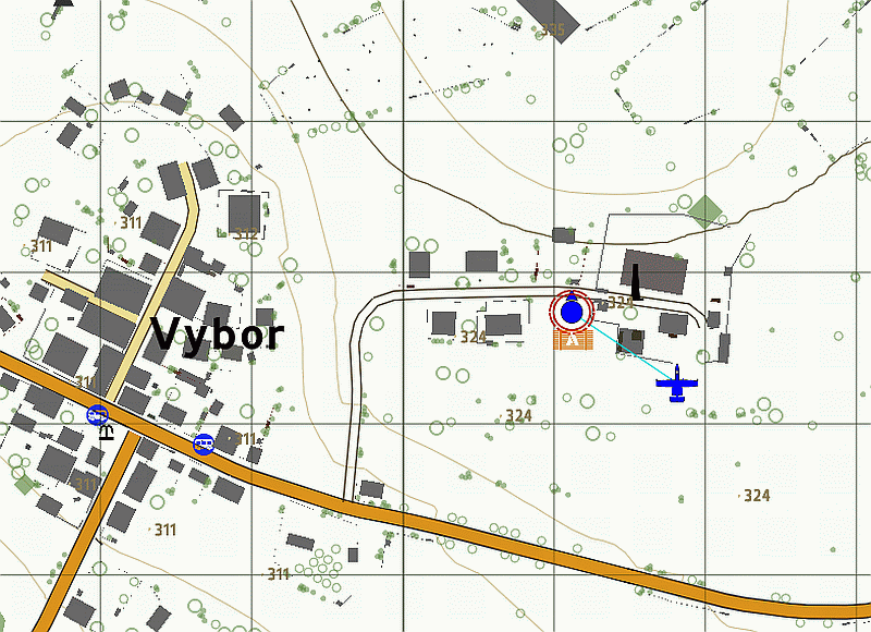

I set it up in the Editor inside 2 minutes. place a man (you), and an airborne A-10.

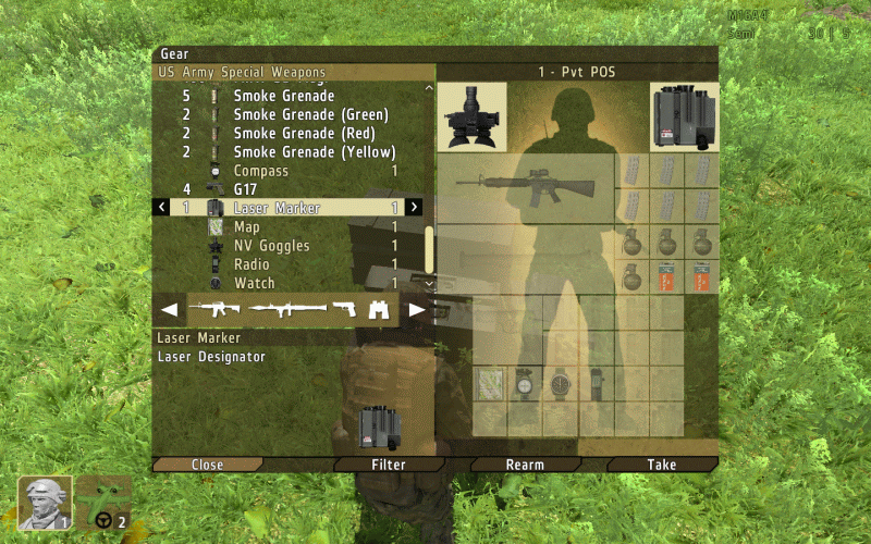

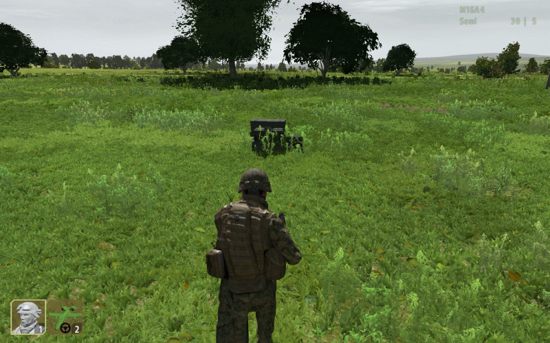

Place a 'US Army Special Weapons' crate (orange box) nearby. (don't forget it's the crate with the word 'Army' in it, and contains a Laser Marker, as some crates don't have one)
Hit 'Preview' to start the game and toddle over to the crate-
Rummage through it and take out the Laser Marker-

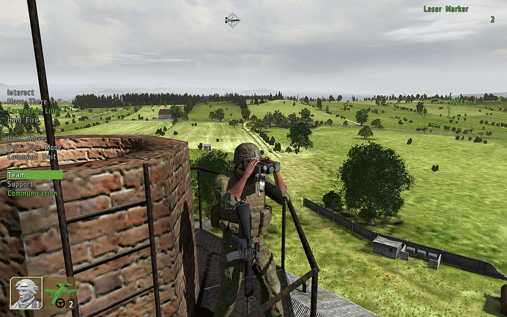

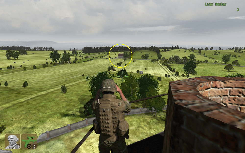

Now go somewhere from where you can eyeball the surrounding area, i climb Vybor chimney, ha ha-

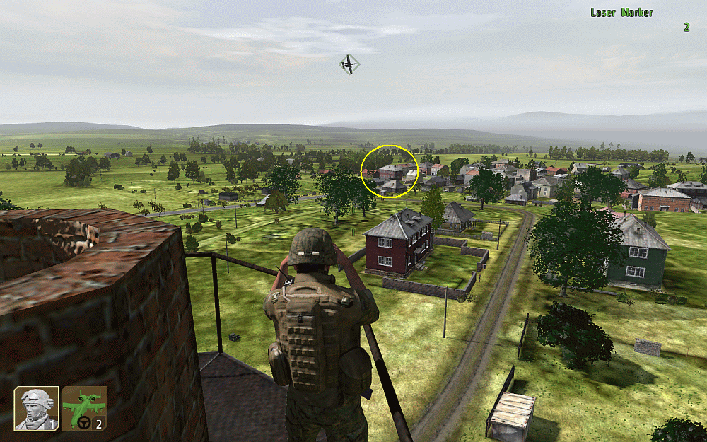

Look around for a juicy target like that building, probably the local enemy Secret Police HQ. Note the A-10 is patiently circling the map-

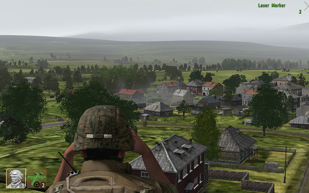

Click the mousewheel to select the Laser Marker, this is it in his hands-

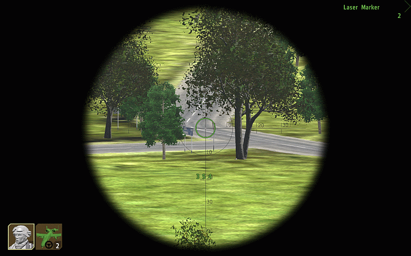

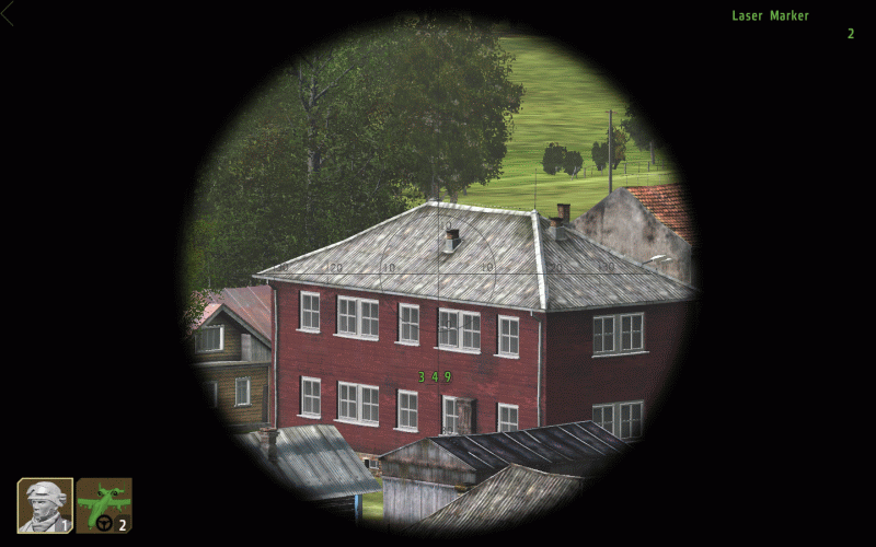

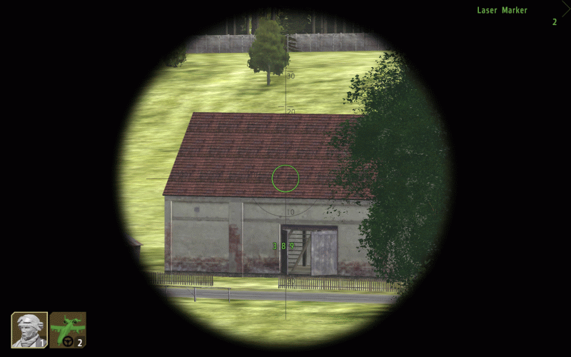

Point it at the building (note it always has a zoomed view)-

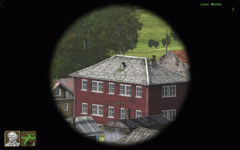

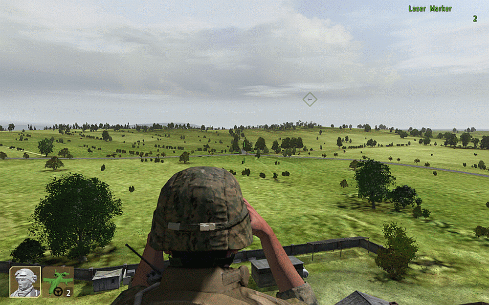

And click the left mouse button to designate it. (you won't see the laser beam but we know it's shining because of that green circle in the middle)

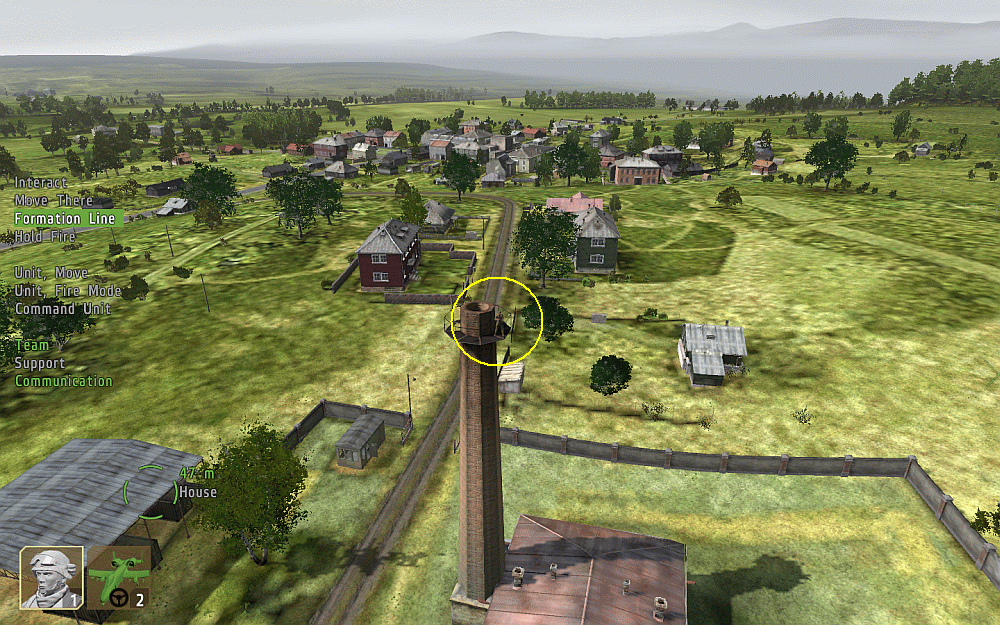

You can hit the numpad 'period key' to zoom to 3rd person view like this if you want to get a better view of things (or even better, hold Alt and pan around with the mouse), don't worry, the laser will stay on the target-

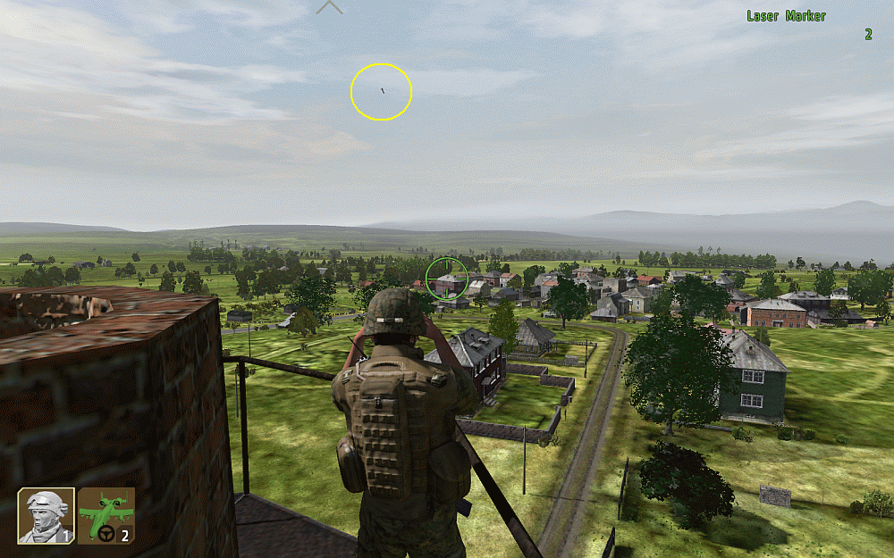

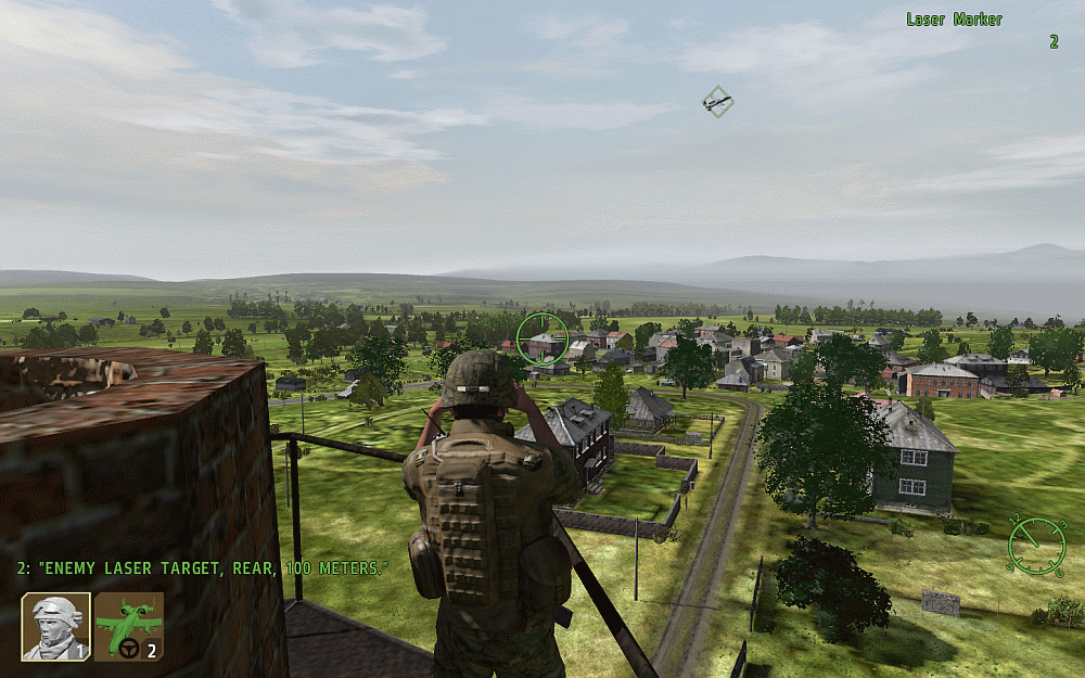

After a few seconds (or a minute or more, it varies) the A-10 pilot radios that he can see the designated target-

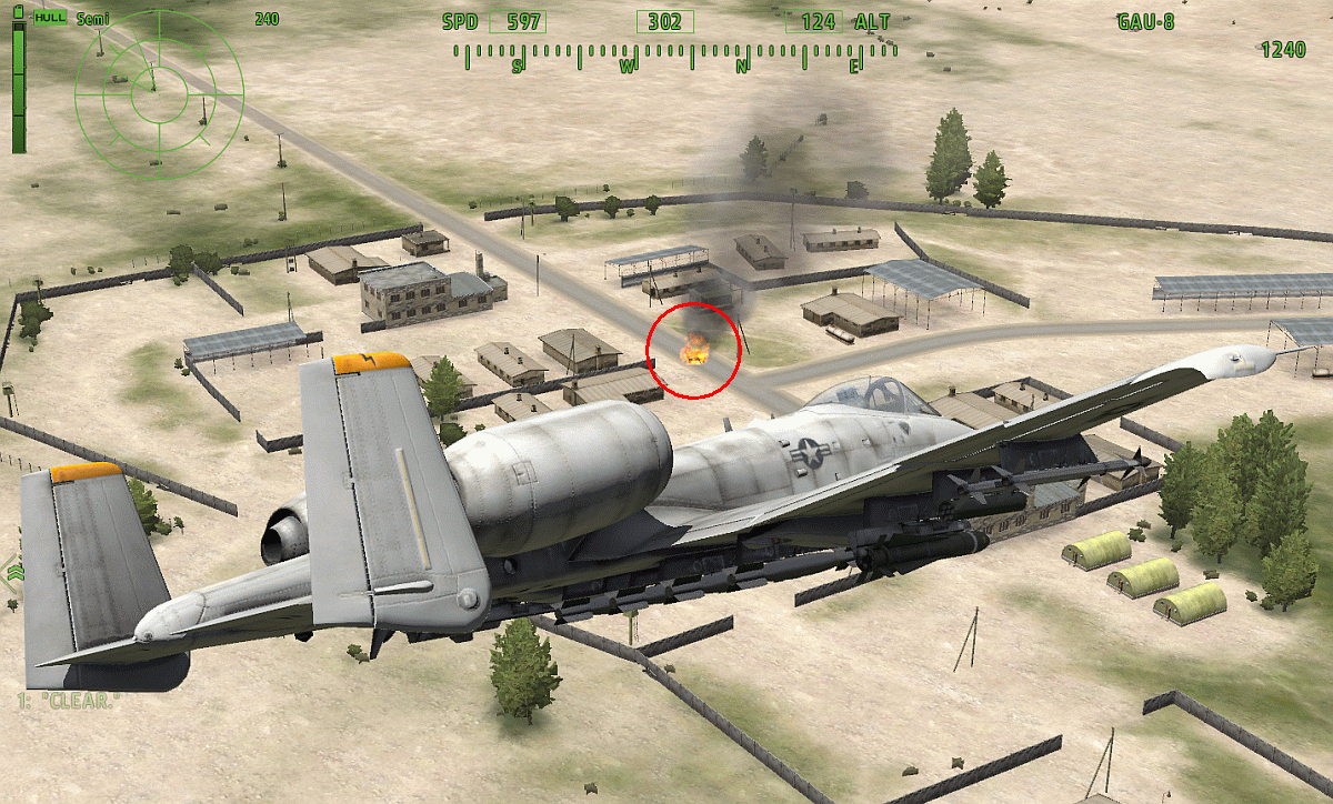

After taking a minute or two to line up for his attack run, he comes in and releases a LGB (circled)-

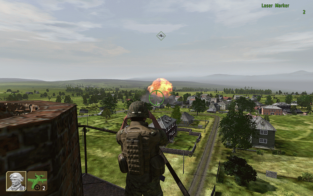

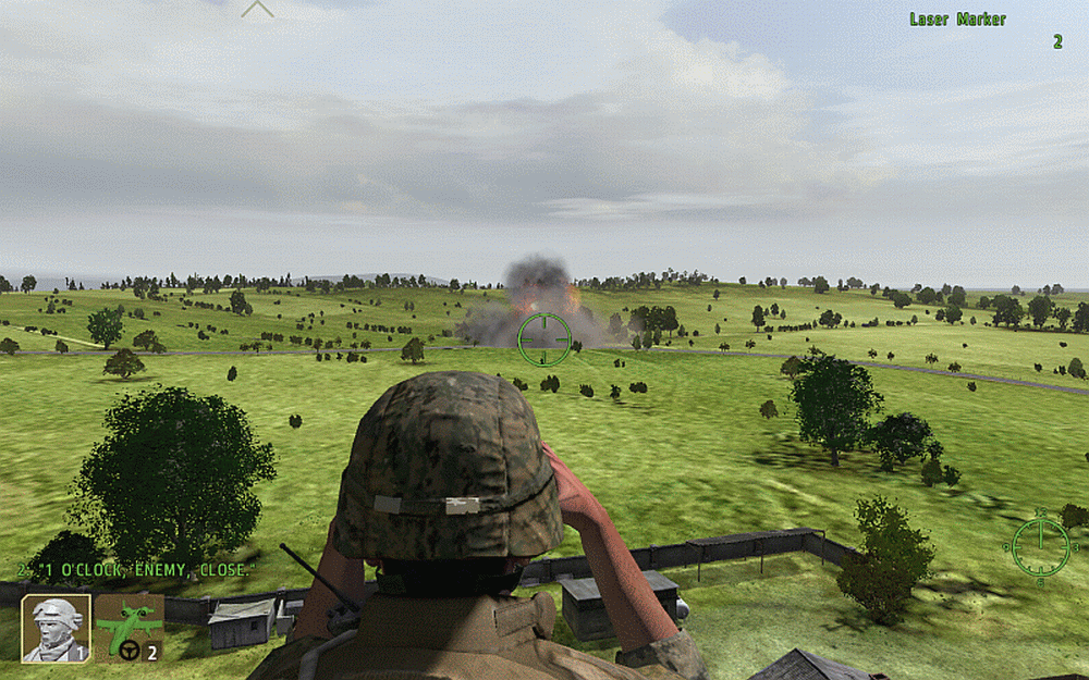

Whammo, the building fireballs-
The building is history. NOW SWITCH OFF THE LASER (left mouse click) or the A-10 might drop another one where you don't want it.

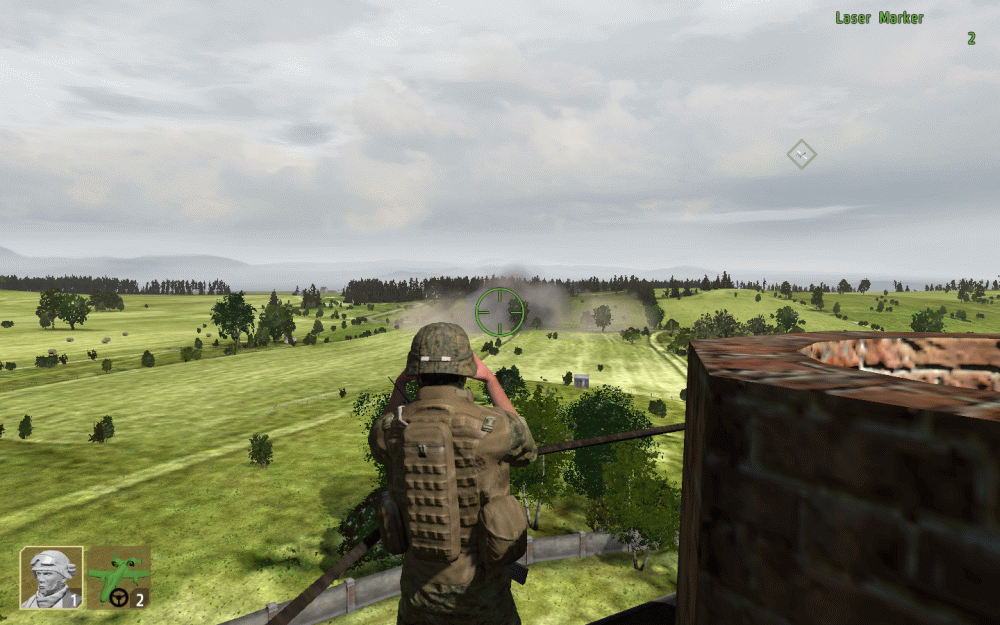

FARMHOUSE-
ROAD JUNCTION
