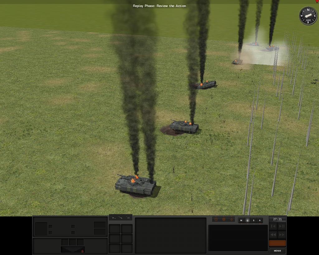

So the BMP-2 didn't do so well against this particular weapon, but how about the brand spanking new Russia stronk IFV, the BMP-3M (ERA).
Test 1
Front
1.TL
2.C=0 P=1
3.TL
Side
1.TL
2.C=1 P=1
3.TL
Rear
1.TL
2.TL
3.C=1 P=1
Test 2
Front
1.TL
2.TL
3.TL
Side
1.TL
2.C=1 P=1
3.C=1 P=1
Rear
1.TL
2.TL
3.C=1 P=1
18 BMP-3Ms and 11 of them with zero survivors. And when there were survivors it didn't do any better than the BMP-2.
Yeah, this was a no-brainer since the BMP-3 is notorious of exploding with the power of a thousand supernovas when hit.
CM%20Black%20Sea%202017-04-08%2017-53-25-38.png~original

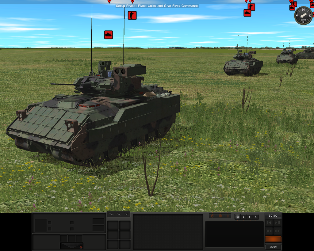

Time to see how M2A3 (ERA) fairs against the MT-12. Same setup as the BMPs except the American squad is 9 men strong and Brad's have a realistic 3 man crew.

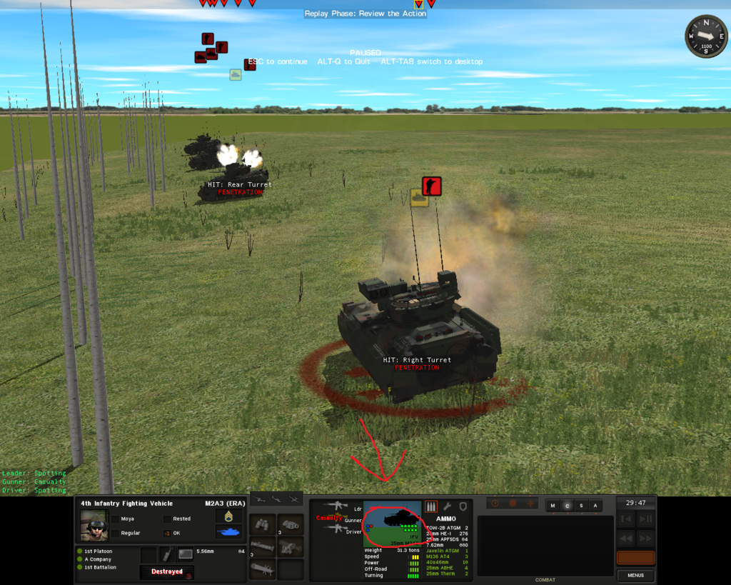

Looks like were getting some variation in here.
Out of 36 Bradleys 10 were total losses. This already is far better numbers compered to the BMPs. Quite often 2 of the passengers survive and you can see several times when 3 survived. When it comes to the crews it looks like being the driver is a death sentence. Gunner and commander have a good chance to survive.
The most interesting thing here is that front number 2 vic from test 4. That Bradley was the only one that took a hit to the turret and only two of the passengers were lost, while all of the crew perished.

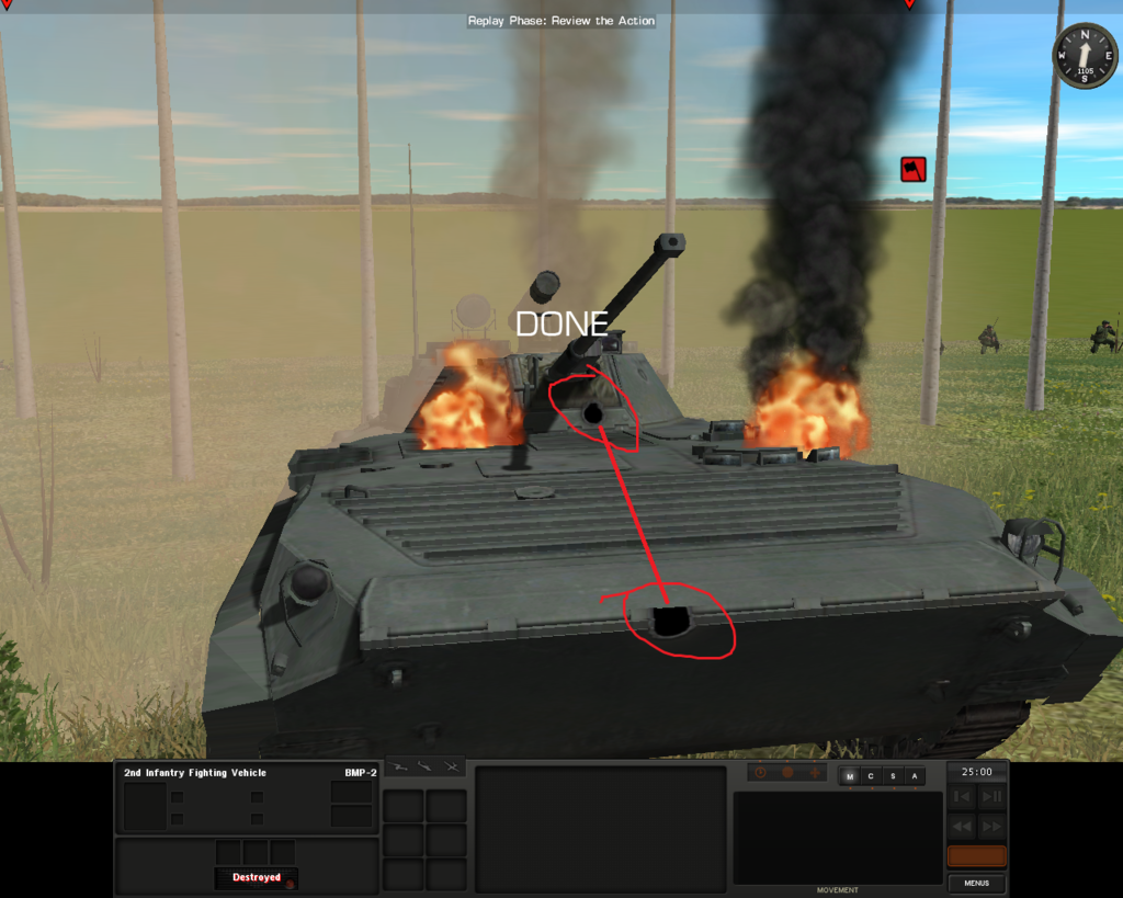

As you can see we have a few more total losses compered to the earlier test. You might think that it's just ordinary variation that can occur with the dice rolls here, but I'd like to offer an alternate hypothesis for peer review.
CM%20Black%20Sea%202017-04-10%2015-15-42-31.png~original
CM%20Black%20Sea%202017-04-10%2015-15-08-50.png~original

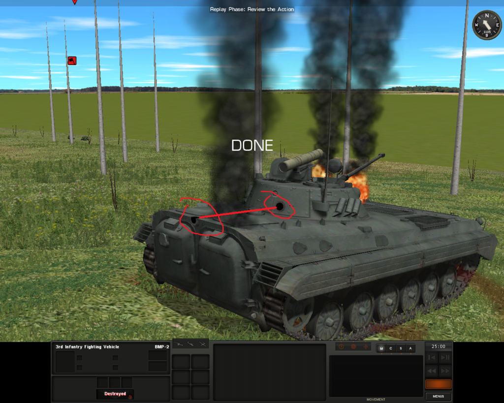

I happened to notice many of the BMP's that were hit on the hull (front and rear) were sporting two hit decals even though I was fairly sure these vics had taken only one hit. And I did check the replays several times and that turned out to be true.
I already knew that CMx2 simulates overpenetration to some extent. I've seen AP rounds pass through vehicles and hit something behind them before.
So I'm proposing that the slightly higher numbers in the total losses is being caused because these vehicles were essentially being hit by the same round twice.
First the round hits the hull and causes damage in the hull -> exits -> hits the turret and causes yet more damage in the same vic, this time in the fighting compartment.
Prove me wrong.
