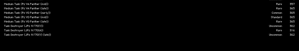

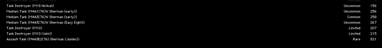

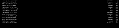

I went ahead and made a selection of all 75mm KwK40 equipped armour in CMFB (all regular/normal/fit/0 leadership
And the 75mm KwK42:
88mm+
And US
75mm:
76mm
90mm
Also here all reg/normal/fit/0 (unless I made screwups lol). Also I cropped out the rarity cost to keep it clear.

I think the most interesting comparison is between the Panther and the JPz IV 70(V). The Panther is better armored (although a larger profile) and has the same gun. It also has a turret. But they cost the same. I feel the Jagdpanther is also quite expensive compared to the King Tiger. Imo the Jagpanther should be more on the level of the Panther. It has a better gun, but a lot less flexibility.
The same could be said for the Stug / Hetzer/ JPzIVs vs the Pz IV. Even the early JPz IV costs ~130% the price of a PzIV J.
Does a early JPz IV have 1.3 times the combat power of a Pz IV?
With the problem being that in QB's, which are a staple for H2H play, a group of otherwise very fine and interesting vehicles in CM are barely be selected (unless for handicaps) simply due to the fact that their combat power/point value is significantly less than other choices in the same roster. Mainly Stug/JPzIV/JPzIV70/Hetzer vs PzIV/Panther, although same could be said about Jagdpanther vs Kingtiger.
And perhaps the best argument with regards to the Shermans would be that the M4/M4A1/M4A3 are too cheap compared to the M4A3(W)75. The improvements (wet stowage, some extra smokes & ammo mainly) don't add much combat power for QBs, but come at a ~20% premium compared to the M4A3.
I'm OK with that particular one because of the 50mm front turret armor on the Pz IV. Against a 75mm Sherman that makes a huge difference.
Of course both Pz IV and JPz IV are overpriced compared to the Sherman.
